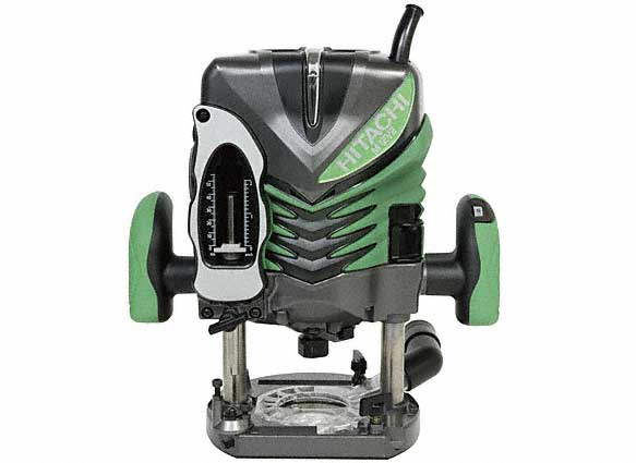

Not sure if this is in the right place, but here goes. I recently replaced the router in my router table, the Veritas Router System. A good brand, 1/2" capable router had been mounted in the Veritas. It was the "sleeve" type, where the router is clamped to the outer sleeve for height adjustment by a lever. It was a nightmare! It would grab pieces as I was feeding them into the cutter as well as chatter on thicker pieces. Using the table was a "white knuckle" affair. I surmise that the sleeve type router was not rigid enough for a router table. Finally I gave up on the router and bought a new Hitachi M12V2:
It was a bit tricky getting it mounted in the Veritas table because the handles are not removable. Once mounted and fired up, I could finally see the potential of this router table set-up. There is no deflection of the bit as you are cutting which means no grabbing or chatter. The variable speed is perfect for bigger cutters. It has an improved collet from its forebear, the M12V as well as a shroud that surrounds the cutter opening that can be hooked up to a shop vac. The pillars that the M12V2 ride on for height adjustment are massive and there is no play. In fact, the pillars are a larger diameter than any other plunge router I looked at, some of which cost $100 more. The appearance is odd, but kind of grows on you.
All in all, a fantastic tool at a really good price.

Thanks for the info! Nice to know -- I'm thinking about getting a good plunger router in the near future. BTW, what's the maximum plunge depth? I need something that can handle 2" and yet still be stable at that extension. Looking at the photo, it looks to be able to handle it.
It does have a certain '60s SciFi look to it, doesn't it? Looks like some nefarious space creature's helmet.

It is listed in a catalog of having 2-9/16" maximum plunge. TRein39076.6399305556
